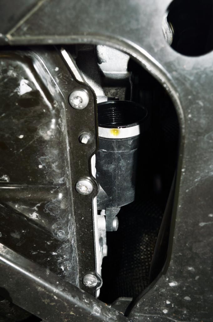

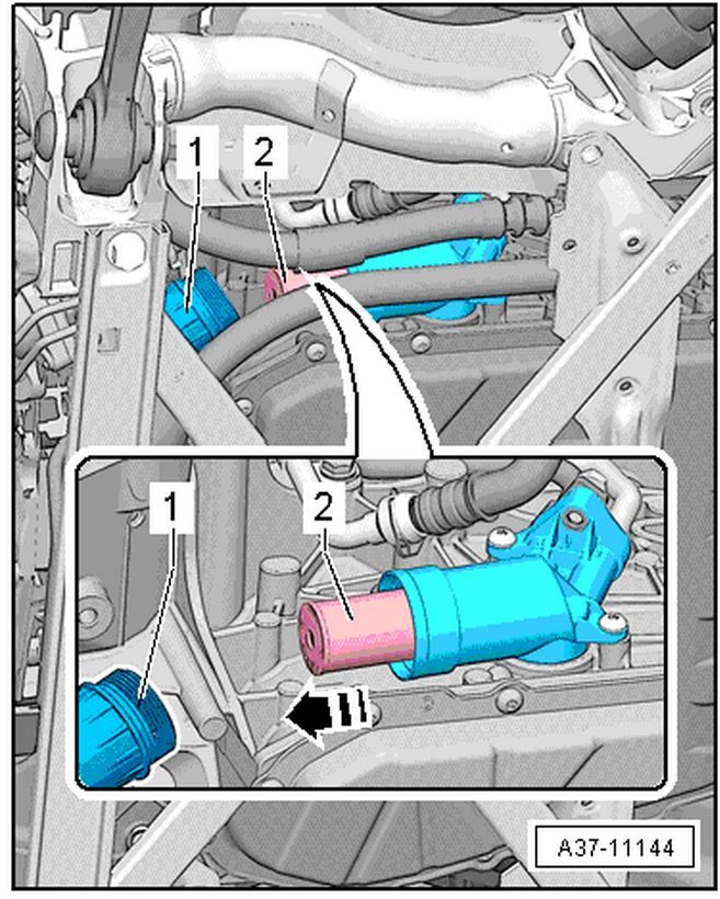

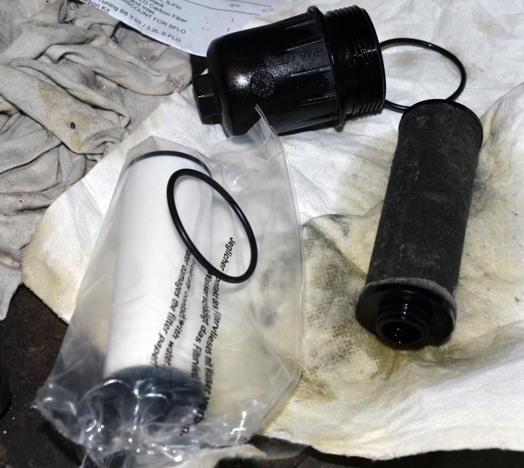

5.  Remove the filter cover using a 17mm wrench.
6.  Reach up and pop the filter out.
7.  Lubricate the new filters small o-ring with some oil.
8.  Lubricate with some oil the new filter cover o-ring and install.
9.  Re-install the filter cover and torque to 8nm.  You can get an extension with a universal to the cover from the front.

Nice DIY. Really helps to see the real photos with the schematics.
