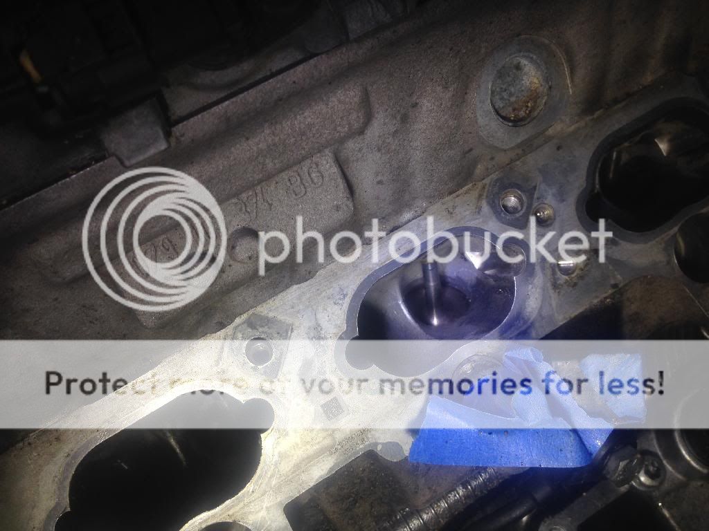

yeeppp.... we had the valves spit shinning clean too. and we used the soda/walnut blaster. new injectors seem to have done the trick, hopefully the rich and lean codes go away too! here's a picture from after the cleaning.

sorry, don't know how to edit posts on here but just something to look at when your manifold is off, i found that the passenger side bank flaps have a bit more play then the driver side... i didn't go to investigate more because i've never had a fault code or power loss from it but just take a look and see if you guys have that problem too...
https://www.youtube.com/watch?v=oqCSrK0mNFY
